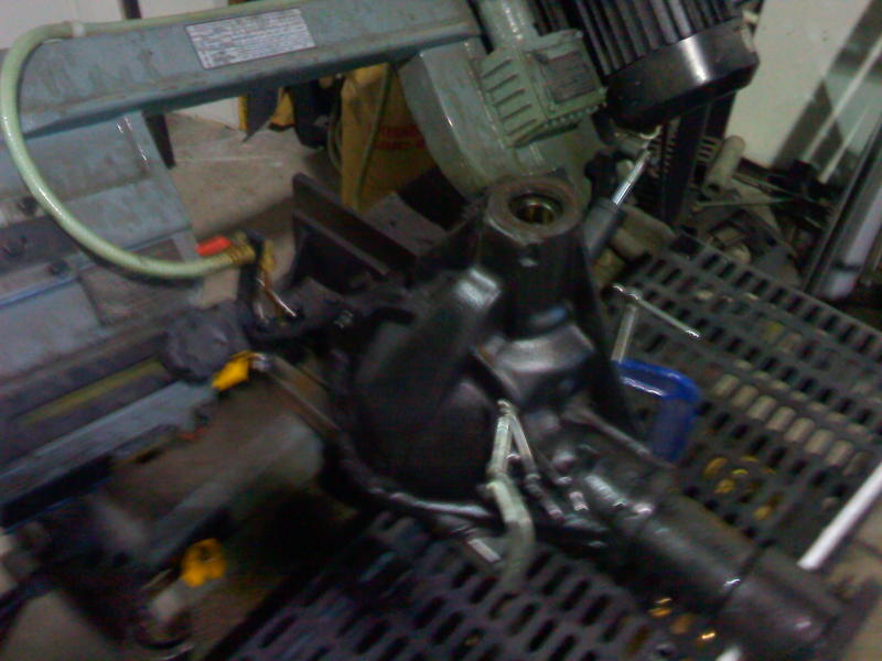

None of this "will it fit or will it won't fit" conversation matters. You make it fit! You simply chop the 10-bolt to match the same length as the AAM-7. The idea is to get rid of all the custom stuff....crossmembers, half-shafts, stub axles, blah blah blah. If you gotta do all that, then I think most guys will be OUT. This thread is how to do it and keep it simple. So are you ready for the missing pics? Here they come! This is a brief rundown of how Blackbear did it...

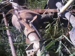

First. Grab any GM front 10-bolt. These are all passenger-side drop and low pinion. Usually 2.73 or 3.08 gears...
Gut it. Clean it. Throw it on a band saw and cut the ps leaf spring mount off the casting. Leave a 1/4" or so....

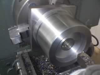

I would mill that cut face, and make sure its 90-degrees to the axle shaft. Then fab and weld-on a steel cup to hold the stock H3 roller bearing and CV-seal. The bearing and seal can be robbed from the passenger-side of the AAM case. The roller is needed to support the inboard end of the CV joint. The seal keeps your oil inside where it belongs...

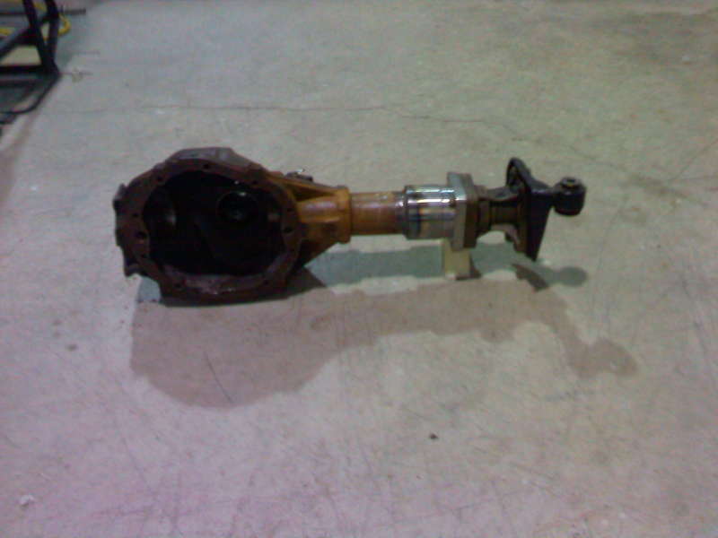

After you have passenger-side done...test fit it against the AAM-7, and line-up the ps ends of both axles. The drivers-side tube can then be cut to match the same total length. I notice some discussions about it "fitting" under the truck...and you should certainly check this. However, I don't think its as big of a deal as you think. Obviously, the pinion centerline will be sitting an inch or so further inboard, and the critical issue is oil-pan clearance. Front driveshaft angle is a non-issue...I don't think you're moving it enough to matter. So just make sure the pumpkin clears the pan. A Rancho lift would help this issue TREMENDOUSLY, and I don't even think it would be close. Unlike Bebe's D44 long travel (which required the pumpkin to be shifted closer to the center of the truck)...the goal on this build is just the opposite. You want to keep the pumpkin as far to the ps as you can, because you're trying to re-use the stock half-shafts. The 10-bolt's driver-side axle tube can be trimmed accordingly, and thats the next step.
Now for the drivers-side. This might be a tad overkill...but Blackbear fabbed an adapter cup. The axle tube fits into one end and the H3 coupler bolts to the other end. Not sure I buy this idea but, that's what he did. I was thinking something a tad less complicated...simply a plate welded to the end of the 10-bolt tube. Regardless...the goal is the same...to mimic the end of the stock AAM-7 tube...
Check the axle against the AAM-7 again, taking into account the extra length of the adapter cup. Chop it. Weld the cup on. Bolt the stock H3 coupler and mounting ear in place...and TAH-DAH!....
The only thing not addressed here is the internal stub shaft. It might be possible to use the stock AAM-7 one but, it will probably be too long. Even so...its a very simple part to make. This is a simple floating shaft that connects the diff to the coupler on the drivers-side. It uses the same splines on each end. Depending on where the new pinion sits compared to the stock one...it might be possible to trim the stock shaft and re-use it. Also not addressed is welding a mounting ear onto the snout of the 10-bolt casting...a relatively minor task compared to this. I never saw this axle installed, and I don't know what ever happened to Blackbear or his axle....so from this point on, its a mystery.
In the end...the goal is to make a 10-bolt that has the same exact mounting points as the AAM-7. It has the same exact seals, splines, and receiver bearings for the H3 half-shafts. It will be slightly taller, slightly longer (front to rear), and the yoke will sit slightly further inboard. Best of all...its got an 8.5" ring gear...you can stuff some 4.56s and a locker in there...and its not a bolt-together, piece of crap, aluminum joke. I think this is a very do-able, feasible mod. I don't even have an IFS in my truck anymore...but, I'm very intrigued and wouldn't mind playing around with this swap. Its a much simpler swap than Bebe's, and a much easier swap than Digger's. You literally ONLY deal with the axle....everything else (torsion bars, rack, crossmember, A-arms, half-shafts, blah blah)....it all stays stock. Its not extreme...but it is very user-friendly, and no doubt a huge improvement.
