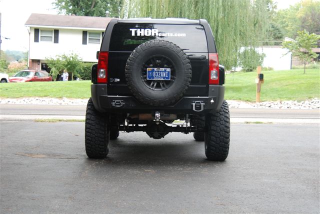

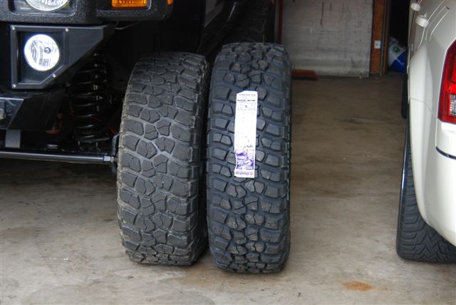

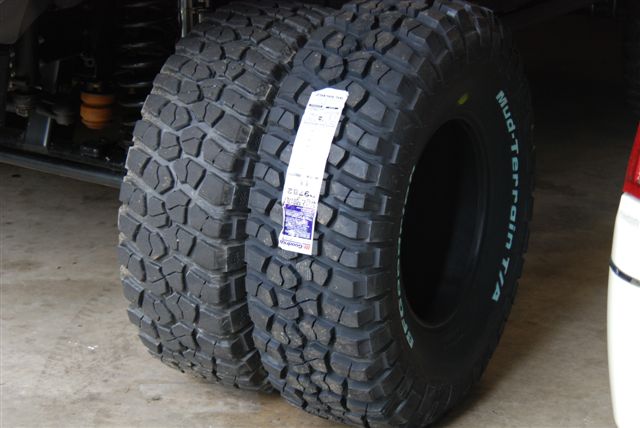

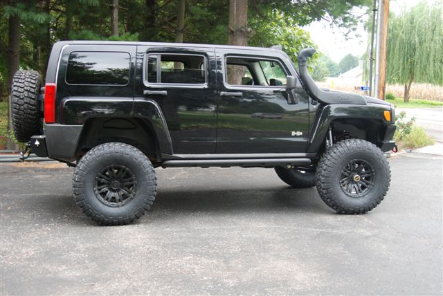

Installed! Here's the new 37 compared to the 35...
They seem to fill up the wheel wells a tad better. They make my truck look "not so tall" but, in reality...it does sit taller...
Ahh yes...the final test. Just barely fits!...
View attachment 6553View attachment 6554View attachment 6555View attachment 6556
