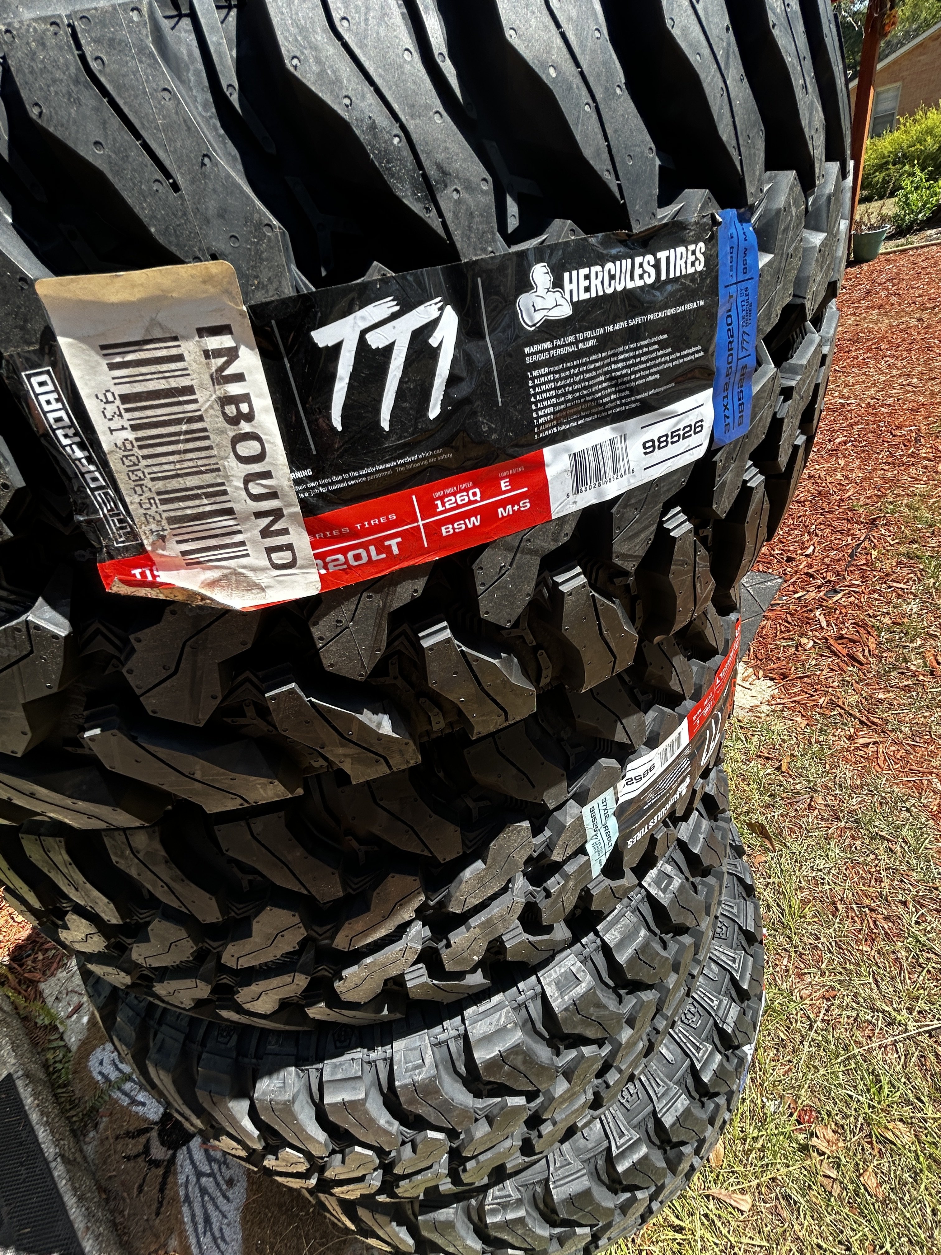

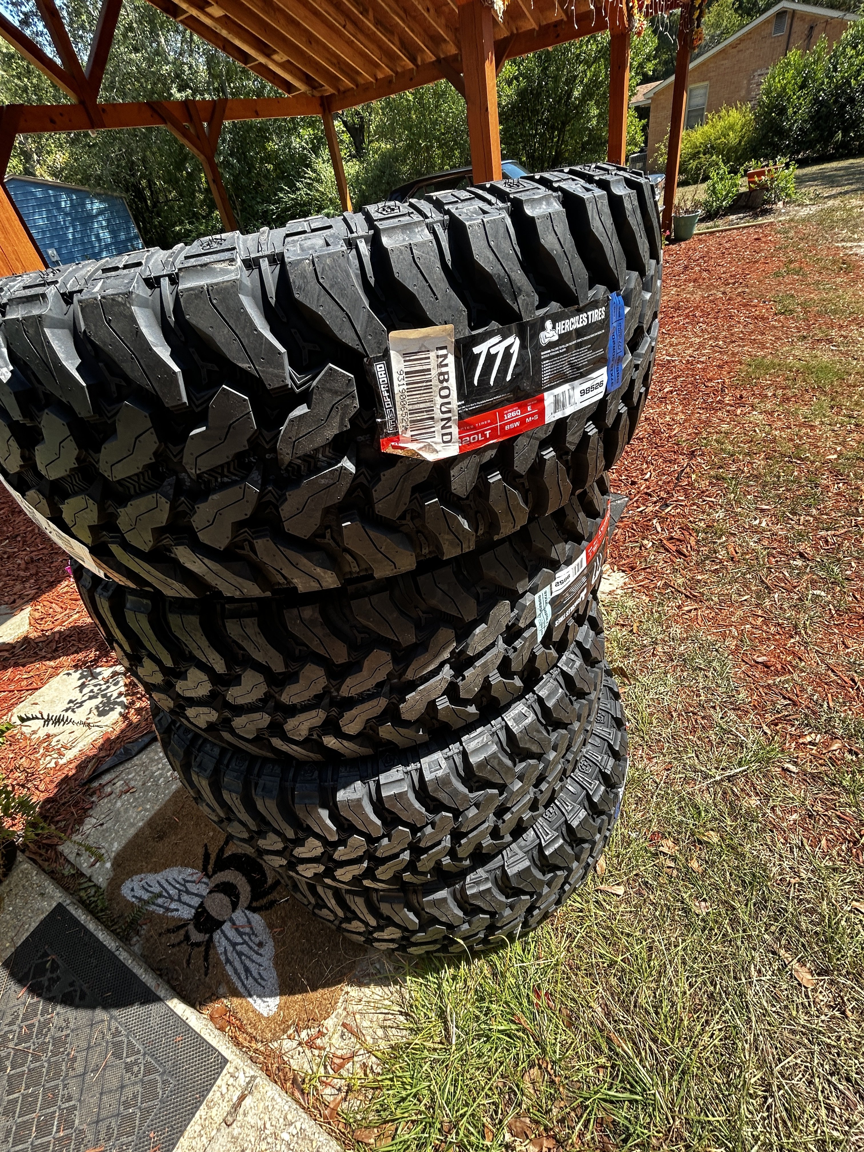

It’s happening hurricane 37x12.50x20 rockstars with a 3 inch bilstein 5100 wulf kit I will post next week
