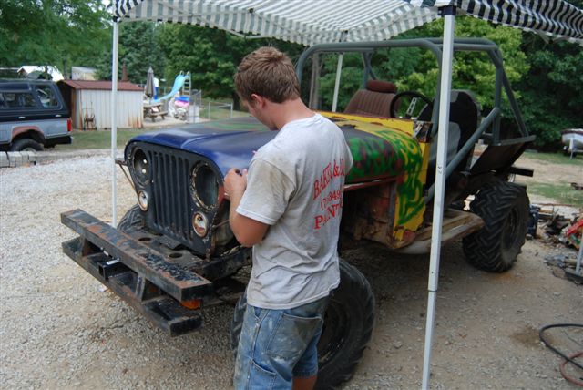

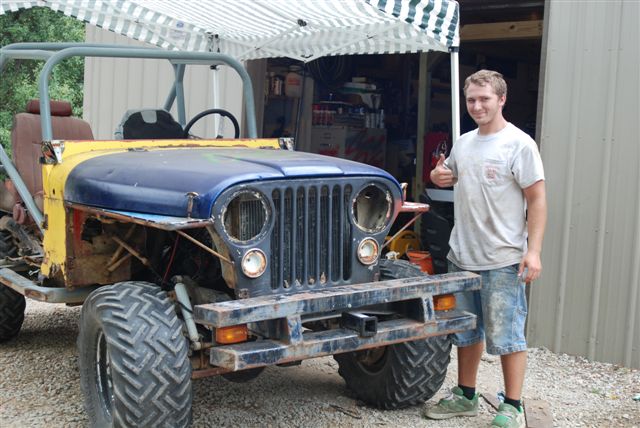

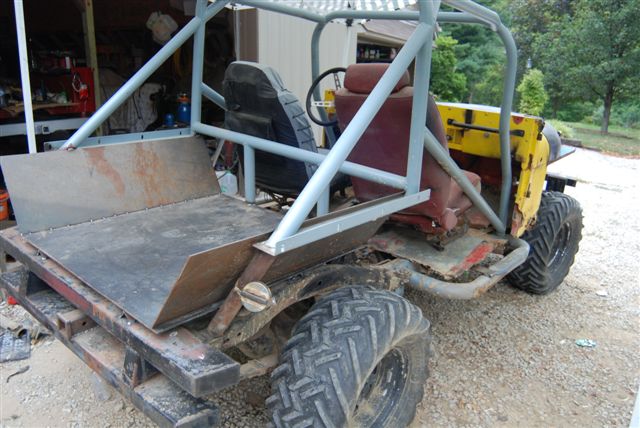

I'm not rippin on Jeep guys. I hang with more of them than Hummer guys and I'm cool with jerry-rigging...just not on my $30,000 Hummer! For example...Here's one of my buddy's rigs:
When I think full-time locker...this is what I picture in my mind. This is one of several Jeeps this guy has, and its actually the best built one he owns! He has another one that uses a piece of clothes-line to hold the clutch pedal up! He runs Lincoln Lockers (welded spiders) on his stuff. He thinks I'm crazy and shakes his head when he works on my Hummer...and I shake my head when I work on his Jeeps (which is every time I stop by). But my wife wouldn't even consider climbing in this turd...and there's no way it would make it even half-way to the mall! Obviously there is a huge range of builds between this CJ and my H3. Even though I respect the wreckless abandonment of all practicality...I like to focus on the other end of the spectrum.

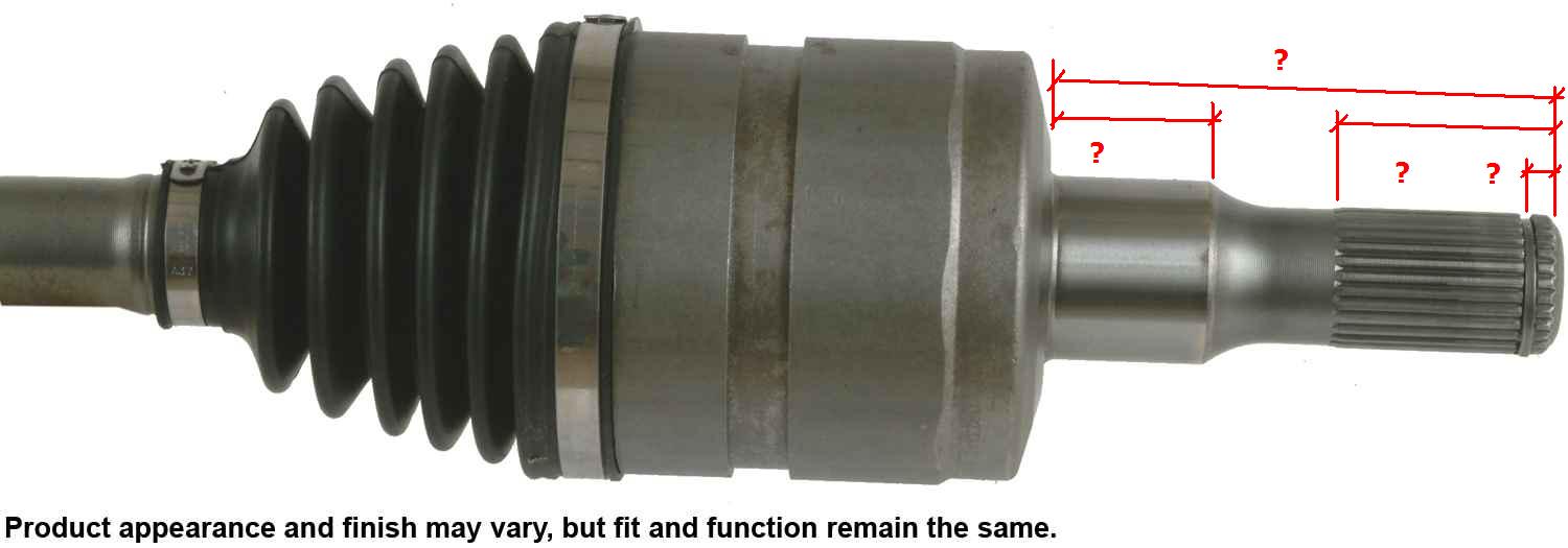

Can you snap me a photo of one of your half-shafts...specifically the end of the inner CV? Lay a tape up against it and snap me a couple pics that show:
The total length of the input shaft. (around 4" I think)
The shiny spot where the seal rides. (around 1/2" from the shoulder of the CV)
The distance from the tip to the snap ring. (around a 1/2" from the end)
I'll be in the shop again tomorrow, and we'll be finishing up the passenger-side. My concern is that we shave enough of the 10-bolt pumpkin away, to get the H3 shaft inserted completely into the 10-bolt carrier like it should be. The AAM-7 measures 1.6" from the outer edge of the CV-seal to the entrance of the carrier...thats pretty compact. I don't think I can get the new seal that close. I've shaved enough to get around 2.1" but, I'm hesitant to go any deeper (starting to encroach on the front cover gasket surface). I basically need to know how much "fluff" I got on the end of that shaft, and whether or not I can get away with this slightly greater distance.

alright...uploading the pics now. .5in is a lot when talking when it comes to this. Hopefully you can safely shave another .25in and have .25 inches wiggle room with the shaft.
